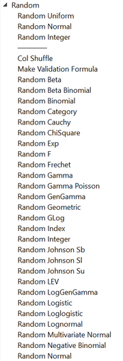

I want to generate a simulated database (n=100, for example) following any probability distributions e.g., Logistic, Lognormal, Weibull, etc. I can do it on EXCEL using  Data>Data Analysis>Random Number Generator
However, I do not know how can it be done in JMP Pro 16.
Can anybody help?
Re: How to create synthetic data?
Create a new column in JMP. Make it based on a formula and look under the Random set of functions. There is a large selection, here is just a subset:
