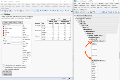

JMP does not allow you to group rows.  Tabulate does not group rows, it simply leaves some rows blank (see below).
If you look at the tree structure for Tabulate then you'll notice that JMP uses special constructs such as MultiTblStrColBox and MultiTblNumColBox to create the tabulate's table.  These are not something that can be created in JSL by the user.  The next best thing is to utilize the <<Get As Report with some fancy group and name handling to create something similar with TableBox -- which we do have access to in JSL.  Here is a quick function "tabulatish" that I threw together that can take a table that has specified colors on it's cells with any column grouping you may desire and creates something like tabulate.  You do need to specifiy a table and special categorical column within:
