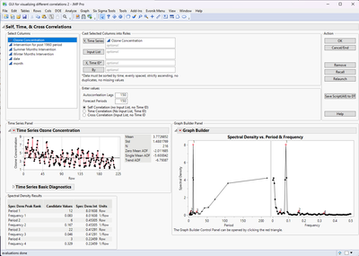

Below is an example of one such output from the analysis:

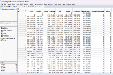

The analysis actually creates another data table in order to build the GB image on the lower right, this data table:
But, when the analysis is over with, or the user performs an analysis on another column, this data table is deleted and I don't have a reference to it anymore -- I tried using the <<Save Script for All Objects to Data Table command, but this requires a reference to the above data table to then generate the graph builder, but the data table is now gone.

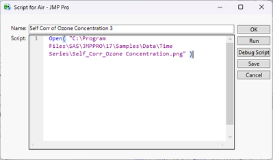

It creates a script to the data table that looks like this:

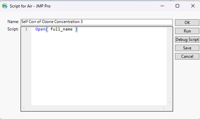

But, the script should be this instead:
Where I've copy/pasted what should be in the script to show what I'm trying to have the main script do. This should be doable, but all the attempts I've made don't work.
