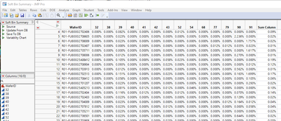

txnelson
Re: How to create column formula using a column name from a list
You were running into an issue where the rows with multiple column names were not being handled correctly.  Here is my attempt at solving your issue.
Names Default To Here( 1 );
Clear Globals();
dt = Data Table( "Untitled 910" );
dt2 = Data Table( "Soft Bin Summary" );
current data table(dt);
// Build execution string
sumString = "";
for each row(
	if(:Yield SummaryBins != "",
		i=1;
		while(word(i,:Yield SummaryBins,"[] ") !=  "",
			sumString = sumString || ", :\!"" || word(i,:Yield SummaryBins,"[] ") || "\!"n";
			i++;
// Remove first comma
sumString = substr(sumString, 1);
// Execute new column string
eval(parse("dt2<<new column(\!"Sum Column\!", formula(sum(" || sumString || ")));"));
// Add the format for the column
dt2:Sum Column << format("Percent", 7, 2);
Jim

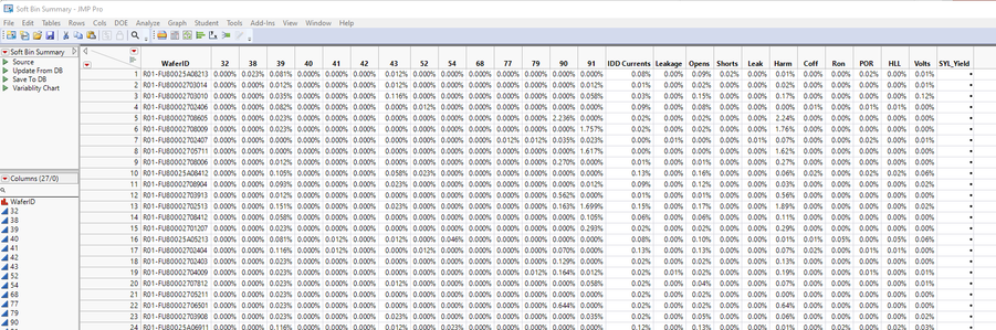

Jackie_
Level VI
Thanks Jim.
Your code works. I want to create separate columns for each group.
For ex: In the below case, There are two groups Opens and Shorts which contains respective column name.
I want to have two different columns with a formula that sums the respective values
Column 1 (Sum of Column (39, 41, 43)) and Column 2 (Sum of Column (38, 40, 42)) in the Summary table

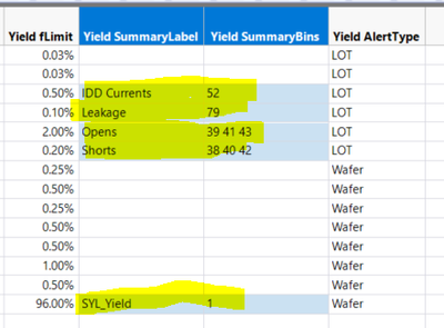

Can it be done dynamically? I've cases where there are more than 2 groups. Writing separate string execution function would be tedious.
I've attached a reference table below
txnelson
Of course it can....what are the rules?
Jim
Jackie_
Level VI
@txnelson The rules are similar to previous example.
Create each separate Column group with a formula that sums the respective bins.
I want to create a Column in the Soft Bin Summary table with addition of all Column name bins in the formula.
For ex: Create IDD Currents group Column with formula (Sum( Column ("52", "42","49") )),
Create Open group Column with formula (Sum( Column ("39", "41","43") ))
and like wise for the remaining label groups in the Yield Summary label column

txnelson
My read of your description is that the rule you have is to create a new column for each row in the Condition Table that has a value in the Yield SummaryLabel column.
So I suggest that you read through each row in the Conditions Table, and when you find a row with a value in the Yield SummaryLabel column, you create the new column.
There is one case where you have an issue.  Row 14 which has SYL_Yield specified, it has a value of 1 for Yield SummaryBins.  There is not a column called "1".
