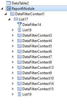

Today, I have been trying to do this with a report module only without the launch module. So with a local data filter at the top (datafilter 14 in the picture below), and then multiple reports below within the same overall data filter context, and additional local data filters for each report. I thought I was nearly done, but just now I realised some of the reports were not getting filtered correctly according to the main data filter, i.e. I was seeing data that shouldn't be displayed. I think I inadevertedly moved the data filter and have been trying to correct this so it's in the right container, and am really trying to avoid starting from scratch again. What's the best way to move /rearrange these so they're in the right position?

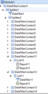

I think I worked out why the above didn't work. See below image. With some of the reports, I added another data filter box alongside the report (example report 13 uses data filter 11). The results are corrected filtered using the overall Datafilter 1.
However for Reports 11 and 12, where I didn't add the data filter along side these, Datafilter1 was not being applied. So when I looked at the results from these reports, I had too many records.
Seems strange to me, but I think I can get it to work now.
Re: How to create an application with a data filter in the launch module?
I would have to look at why Report11/Report12 are not filtered - that seems like a bug.  Two suggestions:
  1. With the layout shown above, don't add a DataFilterContext for reports that don't have an (explicit) data filter associated.
  2. One option to simplify the Application layout would be to add filters to the platform directly, for the case where the filter only links to one platform.  If Report13 in the above example has the Data Filter as part of the platform, you do not need to add DataFilterContext12/List11/DataFilter11 to the layout.
