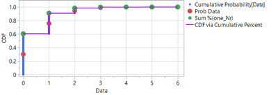

hogi
Level XIII
Re: How to create an CDF plot in Graph Builder
From the discussion there:
dt = Open( "$DOWNLOADS/CDF_Data.jmp" );
new column("one_Nr", formula(1));
dt << Graph Builder(
	Variables(
		X( :Data ),
		Y( :"Cumulative Probability[Data]"n ),
		Y( :one_Nr, Position( 1 ) ),
		//Y( :Prob DataX, Position( 1 ) ) // enable after saving the data to the table
	Elements(
		Points( X, Y( 1 ), Y( 3 ), Legend( 11 ) ),
		Points( X, Y( 2 ), Legend( 2 ), Summary Statistic( "Cumulative Percent" ) ),
		Line(
			X,
			Legend( 3 ),
			Connection( "Step" ),
			Summary Statistic( "Cumulative Percent" ),
			Interval Style( "Band" )
	SendToReport(
		Dispatch( {}, "400", ScaleBox,
			{Legend Model(
				11,
				Properties(
					1,
					{Marker( "FilledCircle" ), Marker Size( 6 )},
					Item ID( "Prob Data", 1 )
			), Legend Model(
				2,
				Properties( 0, {Marker Size( 10 )}, Item ID( "Sum %(one_Nr)", 1 ) )
			), Legend Model(
				3,
				Properties( 0, {Line Color( 8 )}, Item ID( "Count", 1 ) )
If the missing horizontal line and first step from the left edge at 0 to the first point's x-value and up (link ) is OK for you,
the approach via "Line" + "Cumulative Percent" (purple line) is a nice shortcut.
