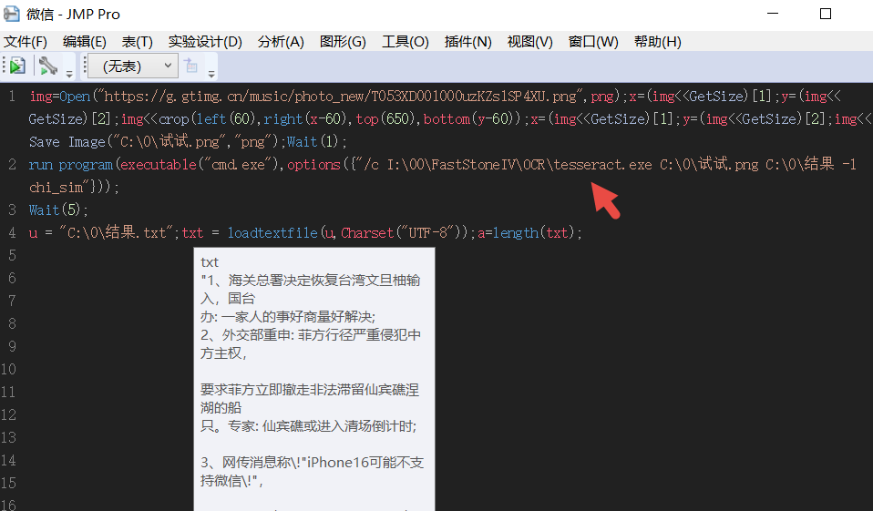

I have solved the picture OCR.
The point is that the address of this picture is different every day and I don't want to get it manually.
See Craige Expert's original blog.But it's too complicated. I don't understand.
So I want to automatically get the real address of the picture for this website.

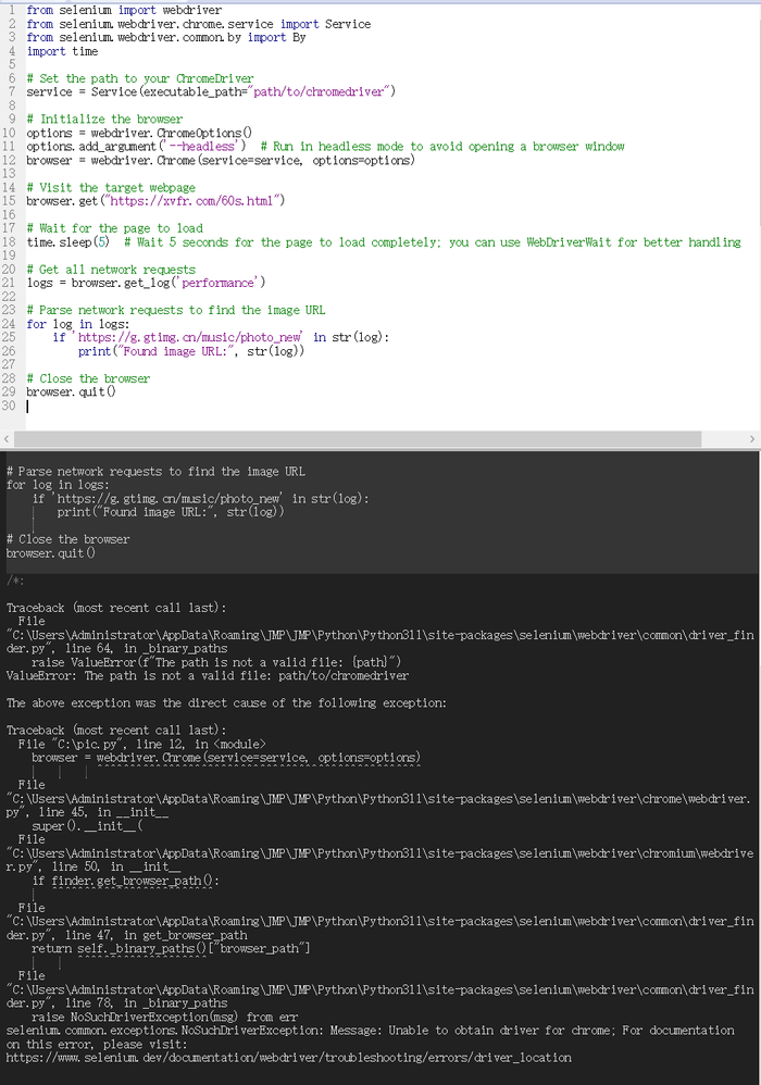

Now I want to figure out how to combine JMP 18 python to automatically get a different address of this image every day to download and recognize JSL.
lala
Level IX
Re: How can use python to manipulate selenium in JMP 18?
ChatGPT
I know even less about python.Thanks!
from selenium import webdriver
from selenium.webdriver.chrome.service import Service
from selenium.webdriver.common.by import By
import time
# Set the path to your ChromeDriver
service = Service(executable_path="path/to/chromedriver")
# Initialize the browser
options = webdriver.ChromeOptions()
options.add_argument('--headless')  # Run in headless mode to avoid opening a browser window
browser = webdriver.Chrome(service=service, options=options)
# Visit the target webpage
browser.get("https://xvfr.com/60s.html")
# Wait for the page to load
time.sleep(5)  # Wait 5 seconds for the page to load completely; you can use WebDriverWait for better handling
# Get all network requests
logs = browser.get_log('performance')
# Parse network requests to find the image URL
for log in logs:
    if 'https://g.gtimg.cn/music/photo_new' in str(log):
        print("Found image URL:", str(log))
# Close the browser
browser.quit()
