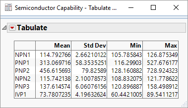

You should use the Analyze==>Tabulate platform.  It will allow you to create report outputs.

In JMP 12 you could use the Columns Viewer (under the column menu).

txnelson​'s approach is clearly a more streamlined and elegant approach.  I'm attaching the following script just to show how you can manually manipulate columns, etc.
