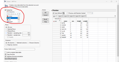

I am not sure what your definition of as "column subset" is.  Is what you are referring to, the data tables created from
     Tables=>Subset
when  Subset By is checked
and a separate table for each level of the variable(s) selected is made?

After I have subset the table, how can I create a loop to add a column "Ref" on all the subsetted tables?
