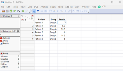

I have a table like this:
Patient        Drug        Result
Patient 1      Drug A      15.0
Patient 1      Drug B      5.2
Patient 2      Drug A      13.1
Patient 2      Drug B      6.0
Patient 3      Drug A      14.5
Patient 3      Drug B      5.0
I basically want to create a linear regression between Drug A and Drug B using all my patient samples. My actual table is a bit more complicated - for example, I have some patients and drugs that I don't want to include. How do I set this graph up in JMP?

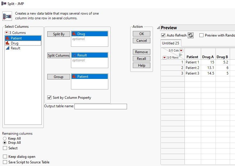

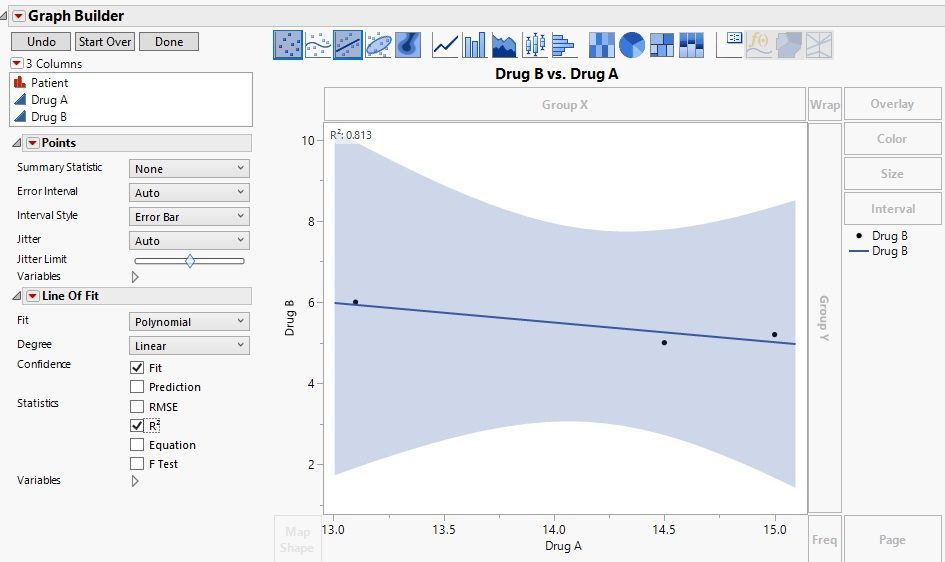

These weren't the solutions I was looking for and I sincerely apologize for not being clearer. My issue was that I didn't know how to put split the numerical data and put each drug on the X and Y axis against each other...without manually copying the data to create a new table. My actual table comes from thousands of .csv files with hundreds of columns. I finally figured it out on my own, however.
As you can see in my screenshots, all I needed to do was to use the Tables>Split function.
