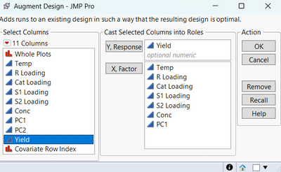

You can change the Temperature Factor Change property from "Hard" to "Easy", and then add your 7 factors as X (6 continuous factors + PC1) and the Yield as Y in the Augment design window :
Then, you can check the option "Group new runs into separate block", and click on "Augment" (or specify a different type of design augmentation).

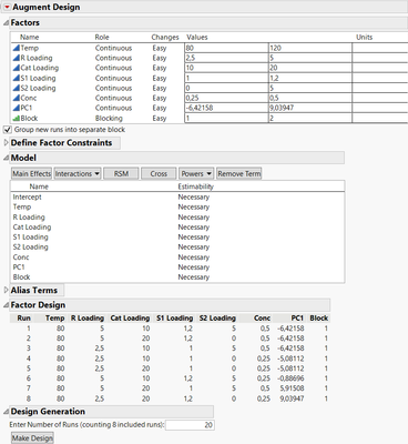

Make sure all your factors main effects are entered in the Model panel (with the added "Block" effect if you have checked the option to group new runs into separate block), and define a suitable number of runs (including the 8 runs already done). In this example, I specified 20 runs in total :

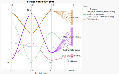

Solvents chosen in runs are done in order to have the biggest difference/variability :

Thanks for the help. The problem with just augmenting with one column is that the resultant design will not explore as much space in PC2. Using your method only generates runs with either TMU or tributylamine, which maximises PC1 but leaves a lot to be desired in PC2.

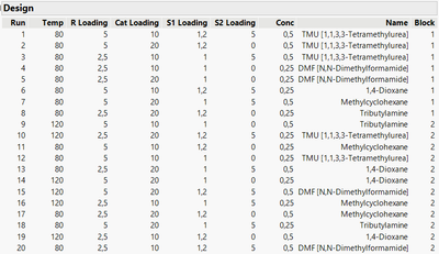

Yes, the best option here would be to augment the original runs using the solvent name as a categorical factor, to make sure the augmented design is not imbalanced regarding the solvent choice.

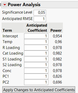

Using 20runs in total in the augmented design, I have a more balanced design regarding the solvent choice in experiments :
And power for PC1 and PC2 is more homogeneous :

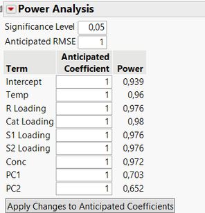

Typically, removing dioxane from the list of solvents in the covariates could help. Here is the power analysis with 12 added runs (20 in total) but without considering dioxane in the covariate list :
