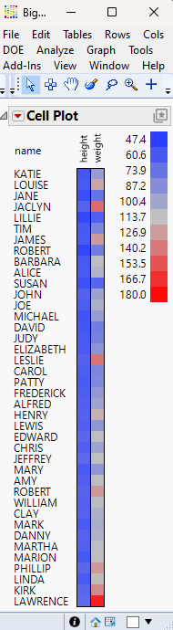

Try using a Cell Plot
     Graph=>Cell Plot
Each column in the graph is a column from the data table, and the labeling also comes from a separate column

The cell plot uses whatever value is in the cell for the specified column.  So if the cell value has the fold change value, that is what will be used in the graph.

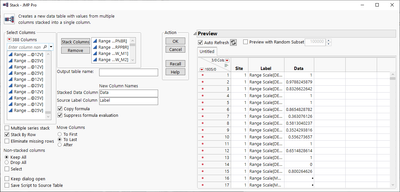

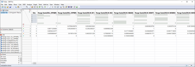

I'm not sure how your data is formatted so I assume your data has few rows and lots of columns. Something like below
You can stack your data

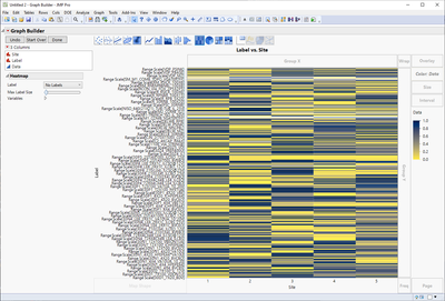

And then you can plot it
