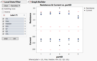

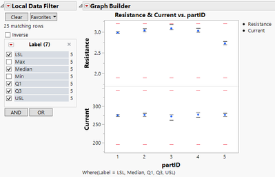

@jthi Thanks for your suggestions on this topic which I am returning to as I have to keep the data format as in my example data attached in this thread earlier. I can get almost what I need with the script below (there could be better ways to do this but below is my tale). I need help with two things.
  1. I need to draw a vertical black line connecting Min and Max for each partID (currently not selected in the local data filter, left chart below). When Min/Max is selected in the local data filter (right chart below), they get connected by a vertical black line (in place of black dots now on right chart), I will get to almost the anatomy of a box plot, which I think is enough and fit for purpose. How to get this vertical line via JSL for each part ID (V Line ()?)?
  2. Secondly, my measured parameters (Current, Resistance in the example data) in actual data will be >40. So, I do not want to do the Legend color setting the way I have done in my script. How to set the legend color as black by default (otherwise JMP colors each Y-group differently and not how I have set the marker colors).

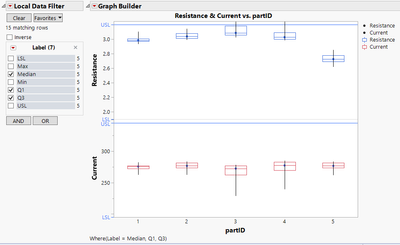

This additional script called by the earlier script (in this thread) does what I wanted. Script is specific to my data but shows a way to plot V Line () within a loop across different Frameboxes.
Changing to BoxPlots on the Graphbuilder with Q1, Q2 and Median selected in the local data filter gets proper boxplots. V line () connects the Max and Min completing the anatomy of a box plot.  As only Q1, Q2 are selected and rest of the data ignored, I think one gets the correct box (selecting more parameters such as Min and Max in the local data filter gives incorrect box).

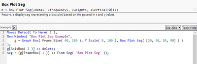

You could try building the boxplot using Rect() and Line() (there is also box plot seg which might work, but you need to simulate the data or use frequencies).

@jthi  Thanks, I think, the box plot seg can be used to do what I want.
From the scripting index example, It is not clear to me how one would generate the box plot for each part ID (on x axis) as in my example data (attached before)
Would I need to loop through the part ID? In which case, how to decide the frame size, scale?
It would be useful if I could get basic example using my example data.

It might be that box plot seg can only be used to create single box plot for a single frame box and it will be in the center
