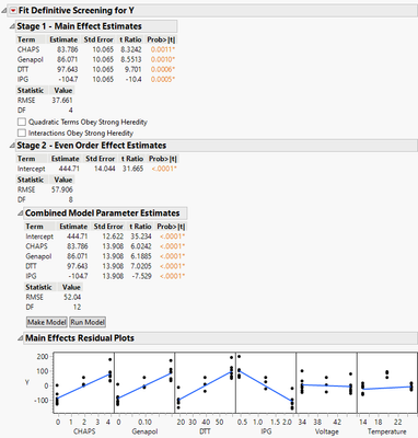

Did you see the Fit Definitive Screening  command in the DOE menu? This platform performs a fully automated analysis and selects the best model for you. You can then jump to the Fit Least Squares platform by clicking Make Model or Run Model button. You can use the Prediction Profiler to explore the response or optimize the response. You can save the fitted model as a new column formula.

Finally, I have already seen that by using the fit definitive screening platform I get a formula of the model that is what I wanted and I can add to the table a column with the predicted values. It is great.

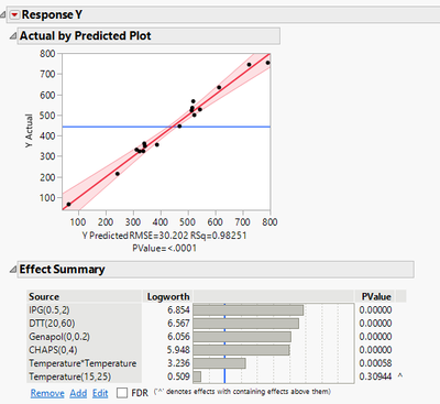

Using JMP 17.0 I get this, turning off the two heredity defaults.  Assuming the math was all done properly (no bugs or coding errors), I must conclude non-heredical temperature * temperature was not statistically significant.  A little surprised.  I can't see a way to get it to show me that in this dialog, a more general question on the DSD special analysis method that I'll post elsewhere.  If I add it manually via "make model" it sure looks statistically significant to me.  Mysterious and gives rise to questioning my assumption that there isn't a bug, math or coding error (but hey, I can't do all the ANOVA and such math myself yet).  A chance for an explanation?
