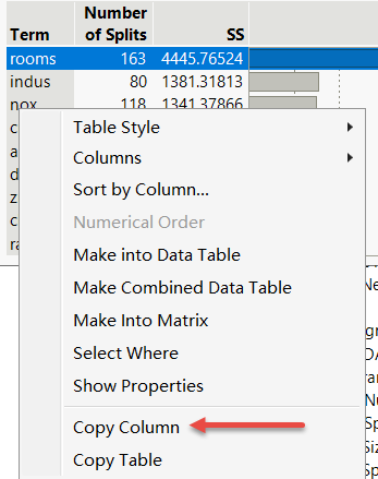

How to copy the list of column contributions of a random forest using a script?
Thanks Experts!
dt = Open( "$SAMPLE_DATA/Diabetes.jmp" );
p= dt << Bootstrap Forest(
	Y( :Y ),
	X(
		:Age, :Gender, :BMI, :BP, :Total Cholesterol, :LDL, :HDL, :TCH,
		:LTG, :Glucose
	Validation( :Validation ),
	Minimum Splits Per Tree( 5 ),
	Portion Bootstrap( 1 ),
	Number Terms( 3 ),
	Number Trees( 25 ),
	Go
p_report = p << Report;
tb = p_report << XPath("//OutlineBox[text()='列贡献']//TableBox");
no work

Use Make Into Data table, take the source script from that and modify as needed
Names Default To Here(1);
rpt = New Window("Diabetes - Bootstrap Forest of Y",
	Data Table("Diabetes") << Bootstrap Forest(
		Y(:Y),
		X(
			:Age, :Gender, :BMI, :BP, :Total Cholesterol, :LDL, :HDL, :TCH, :LTG,
			:Glucose
		Validation(:Validation),
		Method("Bootstrap Forest"),
		Column Contributions(1),
		Minimum Splits per Tree(5),
		Portion Bootstrap(1),
		Number Terms(3),
		Number Trees(25),
		Go
Wait(0);
rpt["Bootstrap Forest for Y", "Column Contributions", Table Box(1)] <<
Make Into Data Table;
rpt << Close Window;
View more...
dt = Open("$SAMPLE_DATA/Diabetes.jmp");
bsf = dt << Bootstrap Forest(
	Y(:Y),
	X(:Age, :Gender, :BMI, :BP, :Total Cholesterol, :LDL, :HDL, :TCH, :LTG, :Glucose),
	Minimum Splits Per Tree(5),
	Number Terms(3),
	Number Trees(25),
	Go
Wait(0);
dt_res = Report(bsf)[Outline Box("Bootstrap Forest for ?"), Outline Box("Column Contributions"), Table Box(1)] << Make Into Data Table(Invisible);
m = dt_res[0, 0];
Close(dt_res, no save);
// could also
m = Report(bsf)[Outline Box("Bootstrap Forest for ?"), Outline Box("Column Contributions"), Table Box(1)] << get;
If you just want the columns, you can build it from the resulting list or
m = Report(bsf)[Outline Box("Bootstrap Forest for ?"), Outline Box("Column Contributions"), Table Box(1), StringColBox("Term")] << Copy Column;
-Jarmo
