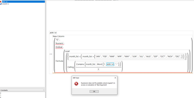

Attempted to apply but perhaps i have input formula with basic error?
jthi
Re: How to convert character date column running APR-14 to JAN-22 into Quarterly (Q1,Q2,Q3,Q4) labels?
Create new column and then add this as formula:
Local({month_list = (month_list = {"JAN", "FEB", "MAR", "APR", "MAY", "JUN", "JUL", "AUG", "SEP", "OCT", "NOV", "DEC"})},
			Ceiling(Contains(month_list, Word(1, :MonthYear, "-")) / 3)
Make sure you have correct column name in :MonthYear (in image below it is A)
-Jarmo
