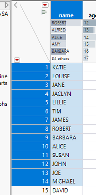

To use a script I'm currently working on, I need to copy-paste a set of cells from a data-table column (multiple rows, one column) into a text edit box (this step is done by the user), and within the script, I want to store this set of character cells into a single string object and separate this string out into constituent strings using the Words() function. However, when I copy directly from the data-table to the clipboard for pasting, the resultant object, when converted to a string doesn't seem to separate cell contents by either a space " " or a newline character "\!n", which would prove problematic in effective use of the Words() function to separate it out. For example, such a set of cells directly copy-pasted from a data table into the text box would look like this:

You seem to have \!n instead of \!N.
For me it seems to work fine with this example (using Windows and JMP16).

I have validated @jthi findings in JMP 15.  The variable "teb_values" contains the text from the Text Edit Box(), with a carriage return, "0D" and a line feed character, "0A" between each line.
