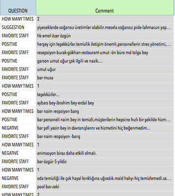

I have a column (comment) with full of text and I would like to replace all exclamation marks with spaces and then collapse whitespace and make all lowercase.
what should be the jsl for:
find "'" + ! % / = ( ) : ; ? _ – ; - . , " and replace with " "
collapse whitespace
make lowercase
Many thanks in advance

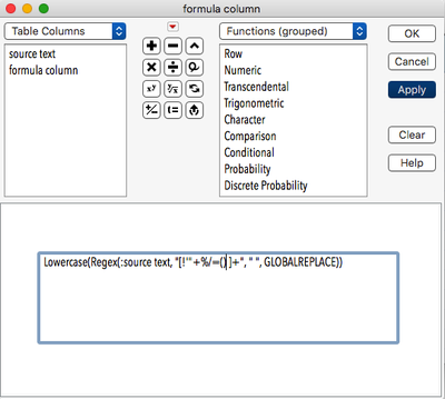

when I fill the expression with exclamation marks JMP stops opeartiong and forces me to force quit the whole application am i doin sthg wrong?
the screenshot is where JMP freezed, dont know exactly which exclamation mark caused it...
Craige_Hales
Re: How to convert char to num
I think I am seeing a quotation mark inside the quoted string in the image you supplied.  JMP strings need escapes too, and it gets confusing.  Try using \!" to replace " in the string.  the apostrophe ( ' ) is OK, just the quotation mark ( " ) needs help.  I get several error dialogs when I do it wrong.  Not sure why you are seeing a hang, maybe the dialog is behind the window.
Lowercase(Regex(:source text, "[!'\!"+%/=()]+", " ", GLOBALREPLACE))

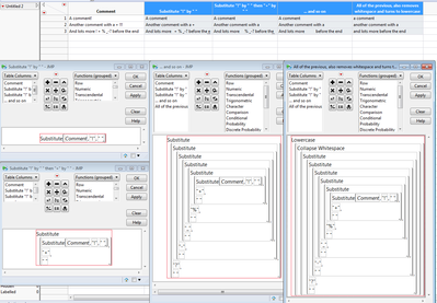

Saitcopuroglu, you can use substitute() to replace any string you want (and special characters are strings). You can have multiple substitutes "inside" each other, with each substituting a special character by a space " ", or nothing "" or whatever you like "really anything".
Then there are separate character functions to remove whitespace and turn to lowercase.
The JMP help (F1) for Character functions is really good to see what can be done; you may want to have a look.
You will find the formula of the last column pasted below the picture so you can re-use it easily. Add more Substitutes() as required to remove other special characters I have missed out.
Lowercase(Collapse Whitespace(Substitute(Substitute(Substitute(Substitute(Substitute(Substitute(:Comment, "!", " "), "+", " "), "%", " "), "_", " "), "-", " "), "?", " ")))
