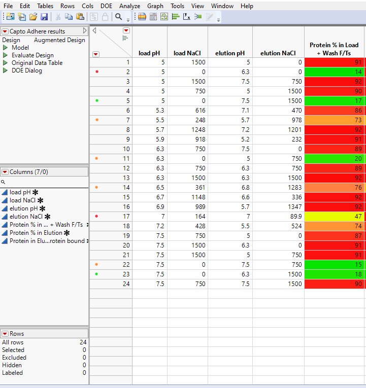

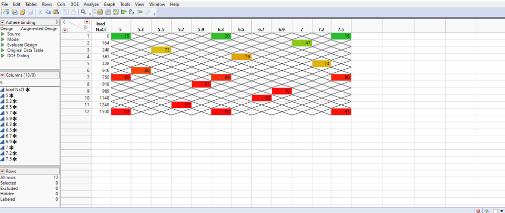

I am reaching out to get some help on a data process problem. Some time ago, I could convert 3 columns (load pH, load NaCl, Protein % in Load Wash) in one table : since it was very helpful, I would like to do the same thing with a new experiment. Unfortunately, I don’t remember how I did it before. You can have a look at the screenshots enclosed to have a better understanding of what I want to obtain.

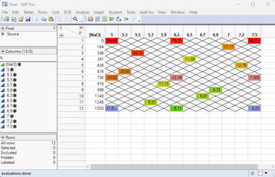

The script I provided was based upon having the Column Property "Value Colors" set.  Apparently your starting data table does not have them set.
I have changed the JSL to use the "Gradient Colors" Column Property.   I also changed the code to set the "Color Gradient" on the initial data table, so it now ensures that when the new data table is being created, that it has what it needs to set the colors for the cells.

For example here, I would like to have the different pH values on the top, the NaCl values on the right and the "binding proportion" values in the table.

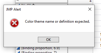

I understand every line but I don't know where I should write in the color theme. I want to use "Yellow Green Red" gradient so I tried to replace "valColors" on line 22 by "Yellow Greed Red" but this is not it.
And when I run the script without changing anything this error message shows up:

Re: How to convert 3 columns in one table
Perfect, thanks a lot !
