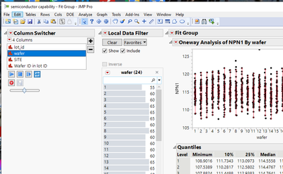

The column switcher is created and works as expected.  What I would like to happen is when the column is switched that the local data filter is updated with the respective values of that column to allow the user to further refine their view of the data. I think I am close.  How should the local data filter be coded to get the column switcher column and then update?

Here is a rework of your code, usiing the Semiconductor Capability sample data table.
Names Default To Here( 1 );
// Open Data Table: semiconductor capability.jmp
// → Data Table( "semiconductor capability" )
dt = Open( "$SAMPLE_DATA/semiconductor capability.jmp" );
test = Fit Group(
	Oneway(
		Y( :NPN1 ),
		X( :Site ),
		Quantiles( 1 ),
		Means( 1 ),
		Box Plots( 1 ),
		Mean Diamonds( 0 ),
		X Axis Proportional( 0 ),
		Points Jittered( 1 ),
		Grand Mean( 0 ),
	Oneway(
		Y( :PNP1 ),
		X( :Site ),
		Quantiles( 1 ),
		Means( 1 ),
		Box Plots( 1 ),
		Mean Diamonds( 0 ),
		Grand Mean( 0 ),
	Oneway(
		Y( :NPN2 ),
		X( :Site ),
		Quantiles( 1 ),
		Means( 1 ),
		Box Plots( 1 ),
		Mean Diamonds( 0 ),
		Grand Mean( 0 ),
	Oneway(
		Y( :PNP2 ),
		X( :Site ),
		Quantiles( 1 ),
		Means( 1 ),
		Box Plots( 1 ),
		Mean Diamonds( 0 ),
		Grand Mean( 0 ),
	<<{Arrange in Rows( 4 )}
// Set the Column Switcher
colpick = test << Column Switcher( :Site, {:lot_id, :wafer, :site, :wafer id in lot id} );
// Add a script to the Column Switcher to change the Local Data Filter
// whenever the selection in the Column Switcher is changed.  When a change
// is detected, the existing Local Data Filter is deleted and a new one
// is created, with the new column that was selected in the Column Switcher
(test << top parent)[listboxbox( 1 )] << set script(
	Try( test << remove local data filter );
	mycurrent = ((test<<top parent)[listboxbox(1)]<< get selected)[1];
	test << Local Data Filter(
		Add Filter(
			columns( column(mycurrent) ),
			Display( column(mycurrent), N Items( 15 ), Find( Set Text( "" ) ) )
// Create the initial Local Data Filter
		Add Filter(
			columns( colpick << get current ),
			Display( colpick << get current, N Items( 15 ), Find( Set Text( "" ) ) )
Jim

Thank you that is exactly what I needed.  And I would never of figured that out on my own.
