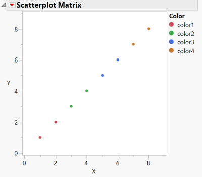

I have been able to make such a plot using Graph/Scatterplot Matrix and selecting X and Y to their respective roles.  I can then make two legends (one for Color and then one for Shape) using right-click/Row menu

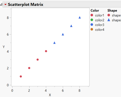

But when I add the second row menu for shape, the colors correspond to categories in the shape column.
I want them to stay as they were in the first screen shot instead of what I see below.
It seems like color and shape are coupled together and cannot be specified separately.

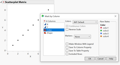

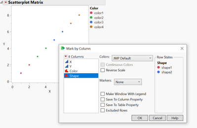

After creating the initial scatterplot from the table above (using Graph/Scatterplot Matrix), right-click on the graph and select "Row Legend".  This dialog box appears:
Select "Color" and JMP automatically assigns colors to the categorical variable using "JMP Default" setting in the colors pull-down option.  This can be changed but I left it as-is.  Note that Markers is pre-selected as "None".  I left this as is. Pressed ok.
On the resulting graph, I again right-clicked and selected "Row Legend".  And I see this:

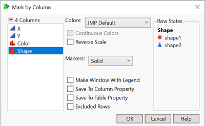

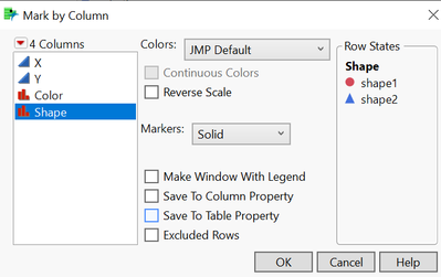

When I click on "Shape" under columns, note that JMP assumes that I want to use this column to again assign a color.  I have to do two things.  First, I have to select a marker scheme from the "Markers" pull-down menu. I chose "Solid" like this:

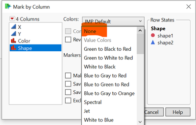

Then, for the most important step, I have to click on the Colors menu and change the pre-selected JMP Default" option to the "None" option which is "hidden" all the way at the top of the pull-down menu.  Here:

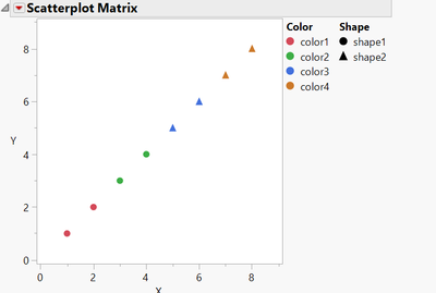

Then click on ok. To get the final graph with two legends.
This is what I want.
The combination of the pre-selected Color menu-item and the "None" hidden all the way at the top cost me hoursOfFun (mostly searching through documentation and posts).  Maybe this dialog box needs a bit of tweaking.  It's the same that is under "Rows/Color or mark by column . . . " so it's a fairly important bit of kit.
