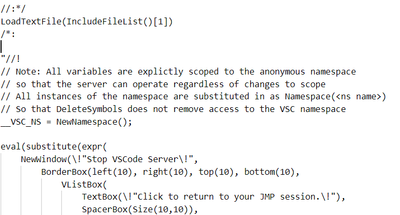

From a running script I would like to do a check if the script is encrytped or not. This is to seperate behavior between development versions and release versions of a script without having to change variables in the code. So something like:
If( !Script is encrypted(),
  //Do bit of code for development version
  //Do bit of code for release version
One way is to check if the script starts with "//-e12.1" which seems to be on the top of all encrypted scripts.
Left(LoadTextFile(IncludeFileList()[1]),8)== "//-e12.1";
But this doesn't work from VSCode as it gives:
so you will always run the release code.

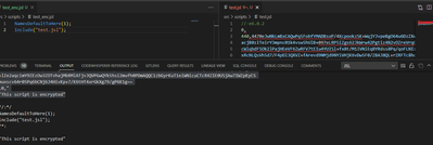

Our vscode extension can't even really run encrypted stuff from the editor unless it's an include.  If it's safe to assume encryption is all or nothing, then I think @Craige_Hales is probably the best option.
If you need to it to be module specific, that's harder as we don't run the expression as an include (because sometimes the file isn't saved so it wouldn't be an include).
Depends on how you're setting up scopes.  Maybe you could just hardcode the name of the file instead of using the includefilelist()?
For example.  I created a script `test.jsl`
Names Default to here(1);
isEncrypted = Left(LoadTextFile("test.jsl"),9)== "//-e6.0.2"; // I had to edit this because that's what my encryption gives.
if(isEncrypted,
    print("This script is encrypted"),
    print("This script is not encrypted")
If I encrypt that script then include it from another script in vscode I can get.
This definitely isn't perfect and assumes A LOT about your structure.  But maybe that's helpful?
