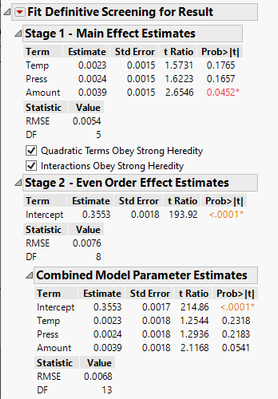

Using JMP 17.0, is there any way to see how it picked the effects it picked as active in the Fit Definitive Screening Report?
For example, the Help file says in Stage 1 with fake factor or center point replicates, an estimator of error variance independent of the model is constructed.  Main effects are tested against this estimate and those with p-values less than a threshold p-value are considered active.  The threshold value, unless set manually, varies by degrees of freedom.  Where is this process shown?
Is that estimate the reported RMSE and the degrees of freedom below it?  If so, then where are the p-values for each main effect so I can see what JMP estimates them as and how they are less than the threshold p-value for each main effect it picked?  I don't see them.  Instead I get a table of t Ratios and Prob > |t|  and that table shows active effects for prob > |t| much larger than the p-value of 0.05 --  like a probability of 0.18, that suggests to me this Prob > |t| is not the p-value it compares to the threshold to determine which effects are active.
I'd even like to see what it estimated for all that it didn't pick as active -- didn't meet the criteria.  By how much?
And the same question for Stage 2.
Sorry, my knowledge and skill involves reading a standard ANOVA table from factorial or central composite designs.  I got JMP because of the special method it uses to analyze DSDs, but I am having trouble learning how to read and understand the results it gives.  Stepwise analysis of my DSD gives a very different answer, picks many more effects with "Prob>F" less than 0.05., using AICc or BIC.  I'm trying to reconcile the two and most importantly, understand the results for the Fit Definitive Screening Design report (prior to run or make model) that is so new to me.

CanonicalHazard
Level III
Re: How to see Fit Definitive Screening Design active effect decisions by stage?
There are 6 factors in the DSD.  The table shows three of them, highlighting one of the three, and not showing the other three at all. Why those three?  And where are the other three?  And why are two of them listed with Prob >|t| well above 0.05?  And the three missing are not shown?
I thought it was only showing those where the p value for the effect was less than the threshold p-value.  If Prob >|t| is the p value, then it is showing two active effects that do not meet that threshold.  And it doesn't show the other three at all.  This suggests to me Prob >|t| is NOT the p value for the effect.
In that case, where is the p value for the effect that it is using to determine if that effect is less than the threshold p-value?  That's my question.  How do I see those p values for each effect so I can inspect that it only picked those less than the threshold p-value.  And I'd like to see the other p values so I can see how far they were from being picked as active.

Yes, sorry, I should have said in my original question it is a 6 factor 17 run DSD depicted in the picture, but my specific DSD is not pertinent to my question.

What I suspect is the answer:
Because I had fake factors (4 extra runs) in my one example, JMP first computed an estimate of the error variance independent of the model.  It then used the YME, which I think is the first column in the Stage 1 output table, and "tested them against this estimate".  I don't know how many degrees of freedom it had for this and I'm puzzled by the fact that if I specify the p-value threshold to 0.2, two of the odd order effects (main effects) drop from the output table.  So I suspect it was using 0.05 and the error variance had more than 2 degrees of freedom.  So it then concluded three of the six odd order effects (main effects) were below this 0.05 threshold, the other three not, so it holds on to the three that were below 0.05.
It then took the variability from the other three main effects and pooled them into the error variance, changing the standard errors, the t-ratios and the p value in the prob > |t| column, which it says in Help that it is the p-value.  So the p-values for two of the six factors are no longer below the threshold because of this pooling of the additional degrees of freedom into the error variance changed the error variance and every resultant calculation.  And the RMSE shown is this final error variance estimate?  The original one before the pooling is not shown and it appears there is no option anywhere to show it.  I'd really like to see it -- or rather, the entire table for all the main effects before the decision what to keep and what not to keep and before the pooling of those not kept into error.
If I am correct, it is interesting the table then shows them as they are no longer with a p-value below 0.05.  It then keeps them. for the Combined Model Parameter Estimates table after Stage 2.
So I"m not sure how to interpret them.  The clean notion that those main effects with a p-value below 0.05 are "active effects" and those not are not active turns into an even more murky grey.  In my example those with Prob > |t| of 0.1765 and 0.1657 are active effects before the pooling of additional degrees of freedom into error, making them what?  Lazy effects?  Ineffective effects?  I like that one. :)  I suspect better names would be obvious effects and non-obvious possible effects.
Perhaps JMP keeps them because they originally had p-values below 0.05, so it might be wise to keep them in subsequent non-screening experimentation.

Here is the example, with made up factor names. Six factors.  The process is a Finite Element Analysis simulation (zero replication error).
It is a 17 run DSD.
I analyze it with "Fit Definitive Screening Design"
I get this
You can see three of the six factors are presented in the Stage 1 table.
The Stage 1 p-value setting is
Question:  Why are Temp and Press listed in the Stage 1 table along with Amount?  The Prob > |t| is NOT below 0.05 for Temp and Press.
Question 2:  Why were Time, Length, Width not listed in the Stage 1 table?
