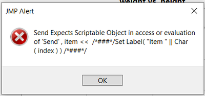

issue with get legend items
In JMP18 (18.1.1) this example from scripting index doesn't work:
Names Default To Here( 1 );
gb = Graph Builder(
	Variables( X( :height ), Y( :weight ), Overlay( :sex ), Color( :age ) ),
	Elements( Points( X, Y, Legend( 1 ) ), Smoother( X, Y, Legend( 2 ) ) )
server = gb << Get Legend Server;
items = server << Get Legend Items;
For Each( {item, index}, items[1],
	item << Set Label( "Item " || Char( index ) )
It produces the error message:
so, Legend Server <<  get legend items()
doesn't return scriptable objects?

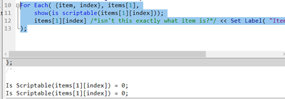

Re: get legend items: no scriptable objects
It actually does return scriptable objects.  Looks like this is a bug with For Each().  If you change the code to something that should be equivalent, it works.
gb = Graph Builder(
	items[1][index] /*isn't this exactly what item is?*/ << Set Label( "Item " || Char( index ) )

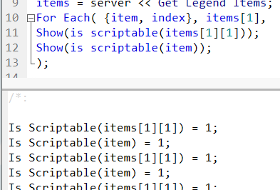

hogi
Level XIII
Ah, sorry, you are right, the individual items are indeed scriptable.
Interesting: a batch message like items << get label produces the same issue.
maybe batch messages use for each in the background ?
Digging deeper, I found an old ticket: TS-00128192
Fortunately, in the mean time the issue got enough prio -- in JMP19 (EA5) it's fixed:
gb = Graph Builder(
items << get label // same issue as with for each show(items[1][1]) items[1][1] << get label(); // OK, on the lowest level, there is a scriptable object Show(tmp = items[1][1::2]); // then this is a list of ... tmp[1] << get Label(); // ...no

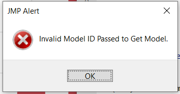

on the other hand ... a bit surprising:
JMP19:
