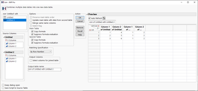

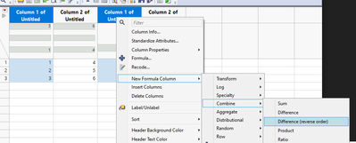

Not sure where the results should be calculated, so I will demonstrate fairly simple process which will create new table with the result
Join tables together using By Row Number
Pick columns in pairs and create the formulas
And you should end up with the result columns as formulas
-Jarmo
