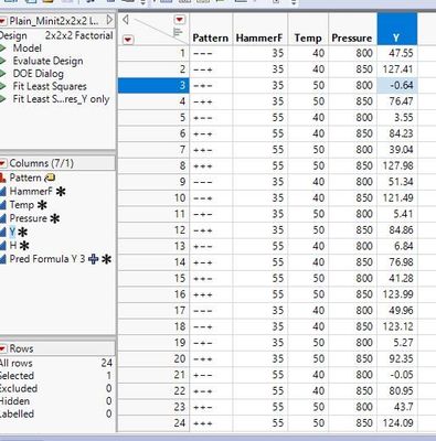

I have this DOE data to analyse. Experiment in triplicate.

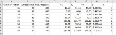

1st question: In excel sheet, I can easily calculate the standard deviation of each condition in triplicate (see below first screenshot).  But in JMP, it will not allow me to arrange the data array and calculate like in excel, JMP put all Y (response) in one column including triplicate Y values (see below second screenshot).  I don't know how to calculate the standard deviation of the triplicates of each condition in JMP in a nice and easy way.

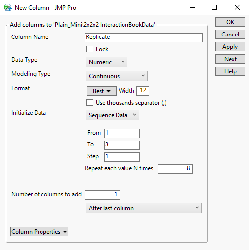

First, create a new column for the replicate. Your data is sorted, so it is easy. Select Cols > New Column and complete this dialog as:

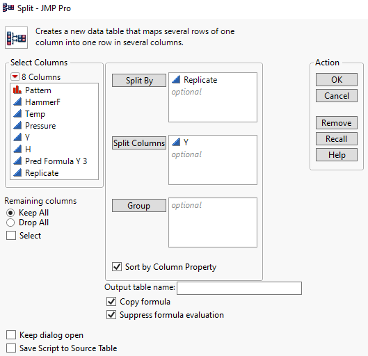

Now select Tables > Split and complete this dialog as:
At this point, select the three new response columns (1-3) and then right-click on their header, select New Column Formula. There are groups of functions that include Mean and Standard Deviation.

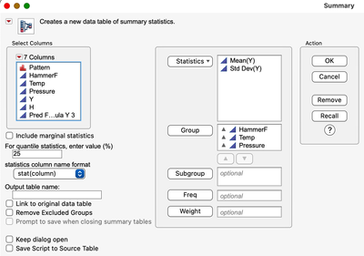

1. You have 3 "data points" for each treatment and these are repeated measures (vs. replicates).  First organize the data so the repeats are grouped together in the data table (e.g., sort by Pattern).  Then use Tables>Summary, highlight the Y and click on the statistics button to have JMP calculate the summary statistics (lots of options).  Put the Hammer, Temp and Pressure in the Group box.
2. You will now have a response of std dev to analyze as a Y in Fit Model platform.
3. Easy to do as above.
