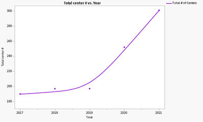

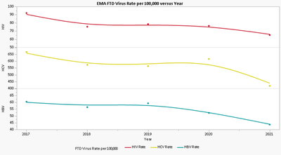

I am trying to figure out how to use both of my Y axis using all continuous variables. I know how to do it in Microsoft, and so there has to be a way JMP can do it better. I have attached the file (using JMP v 16) and it includes the 3 scripts (a center v year, an FTD, and an RTD). I want to keep the red/yellow/teal graph the exactly way it is... but I want to add the purple graph to the red/yellow/teal graph but have the purple axis on the y axis right side (label group Y in graph builder) instead of the left and have the purple line go through all 3 of the red/yellow/teal graphs. I am trying to show that rates went down as the number of centers went up. This is my first time posting a question, so please let me know if there is a problem with any files or graphics.

Hello and welcome to the community! You will want to add that Total Center #  columns to the inside of the y-axis of each panel which will mean you start with the two variables on the same side. Then right-click on the y-axis and select Move Right. There you will see the columns that you can send to the other y-axis.

I was able to get the total centers on the right hand y-axis... I see how to do it for each of the 3 sections, but is there a way to do it so that the total centers is all 3 together instead of individual?

Are you going after something like this? It makes some of the rates tough to see.
Alternatively, how about taking a ratio of your values to the initial values just to show the % of initial value? That would put them all on the same scale and make it easier to see.:

Hello, I am sorry I don't think there is any good way to have one graph overlay three others like you show. Hopefully you can find plenty of other alternatives to visualize your message. Perhaps just adding a reference range to highlight the period from 2019 to 2021 when centers were increasing would help focus attention in each pane on the relevant period? Just an additional thought to consider:
