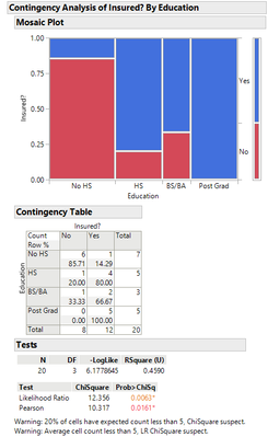

I don't think (s)he is looking for an inferential result.  I am guessing that insured is a dichotomous variable and education is nominal in the categories suggested.  So, if you do a Fit Y (insured) by X (education) the resulting table row % are the probability of being insured for each educational level.
SDF1
Re: How to calculate probability of being uninsured
Hi @dale_lehman ,
  So you're thinking they're looking more for a contingency table? That also makes sense. That's just changing the data type in my example table. Something more like this:
Is this what you're after @henggar313 ?
