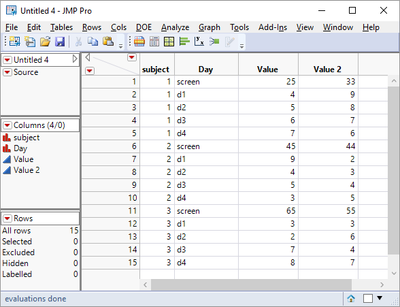

Hello all,
I have the following table.  For each subject, I would like to calculate the % difference of the d1, d2, d3 and d4 values in the Value column relative to the screen value.  The formula is ((d1-screen)/screen)*100, repeating for the d2 through d4 values for subject 1.  Then when the subject number changes, the screen value for subject 2 is referenced for the calculation using subject 2's d1 through d4 values, etc.  I am sure there is a way to do this but I have not been successful in identifying one.

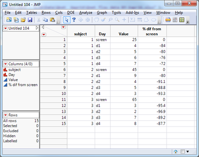

Here is a simple script that does what you want:
Names Default To Here( 1 );
dt = Current Data Table();
// Create a data table with just screen values
dt << select where( :day == "screen" );
dtscreen = dt << subset( selected rows(1 ), selected columns(0 ) );
dtscreen << delete columns( "day" );
dtscreen:Value << set name( "Screen Value" );
// Combine the data back together
dt << Update( With( dtscreen ), Match Columns(:subject = :subject ) );
Close( dtscreen, nosave );
// Make the final calculation
dt << New Column( "% dif from screen", formula((:Value - :screen value) / :Screen Value ), Format( "Percent", 7, 2 ));
Jim

If I am interpreting your expansion request correctly, your data table would now look like this?
Using the method that I originally proposed, the script would have a couple of minor changes:

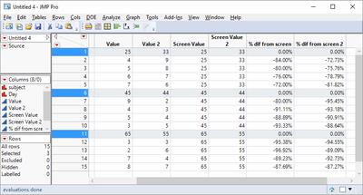

This would give you a final table looking like:
There is an advantage in using the methodology that MS proposed, in that it can be accomplished just by specifying a formula for the new column.  However, it does rely on determining the Screen row position , which may not be a valid assumption when you are using this with real data.
