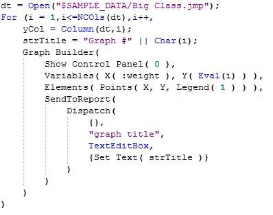

Here is an example - it uses the Eval function to evaluate the variable that contains the column reference:
For( i = 1, i <= N Cols( dt ), i++,
	yCol = Column( dt, i );
	strTitle = "Graph #" || Char( i );
	Graph Builder(
		Show Control Panel( 0 ),
		Variables( X( :weight ), Y( Eval( i ) ) ),
		Elements( Points( X, Y, Legend( 1 ) ) ),
		SendToReport( Dispatch( {}, "graph title", TextEditBox, {Set Text( strTitle )} ) )
Unfortunately I still have no idea how to cut and paste JSL whilst maintaining its formatting - this is what it looks like:
	Graph Builder(

rleeper
Level III
Re: How do I use a variable inside the graph builder script?
David,
Thank you!
I just changed one line and now the name of the graph is the column name, you rock!
strTitle = Char( yCol )

ankursaxena
Level I
@Hi,
I have a quick question on this. (If someone sees this message, this comes roughly two years after the last reply).
The above code works perfectly fine for me, but I am not understanding why Eval(i) is used for Y variable in the Graph builder code in the line below. Shouldn't it be Eval(yCol(i)) ? Eval(i) will just give 1,2,3 ... etc ,then how does it work fine?
           Variables( X( :weight ), Y( Eval(i) ) ),
Thanks,
-Ankur
David_Burnham
Super User (Alumni)
You are correct - I think it was a typo - it should be Eval( yCol )
