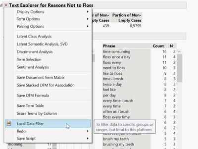

you may have a look at text explorer (main menu analyse),
please see the following example as script, or in scripting index, or in statistics index (main menu help).

Hello
did you check out the "Local data Filter" to chose the documents you want.

Re: How to calculate TF-IDF
The TD-IDF is one of the built-in transforms that may be applied to the document-term matrix when you save it back to the data table from the Text Explorer platform.

Thanks everyone for your help, with your collective help I have managed to find the solution:
Under text explorer, go on save document term matrix and the option for TF-IDF is found under weighting.
