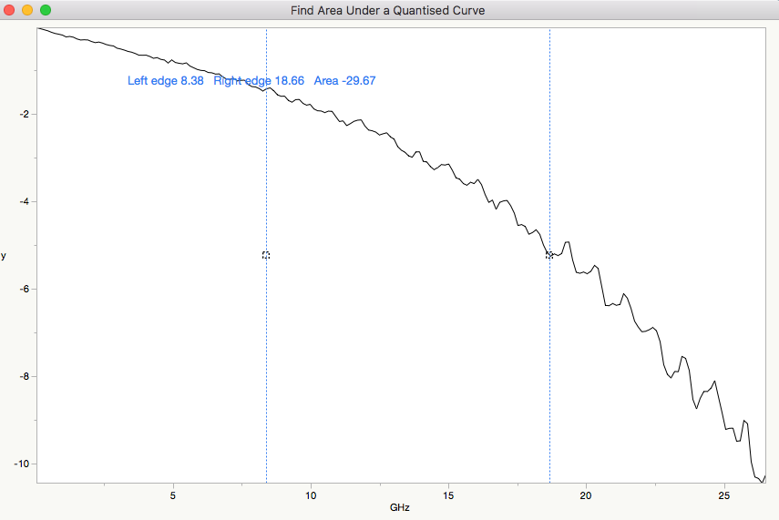

Here's a (now rather old) script, though you will have to organize your data differently. It was intended to be interactive:
but it would be easy to remove this aspect and make it work for multiple Y's.
