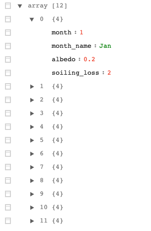

I had a transcribing error going from picture to text.
Re: How to build a dynamic JSON object
If I rewrite it like this using the chrome add in JSON Editor, I see a List of Associative Arrays

This seems to work.
innerList = {};
InsertInto(innerList, [ "month" => 1, "month_name" => "Jan", "albedo" => 0.2, "soiling_loss" => 2.0]);
InsertInto(innerList, [ "month" => 2, "month_name" => "Feb", "albedo" => 0.2, "soiling_loss" => 2.0]);
InsertInto(innerList, [ "month" => 3, "month_name" => "Mar", "albedo" => 0.2, "soiling_loss" => 2.0]);
monthlyFactors = {innerList};
je = As JSON Expr(EvalList(monthlyFactors));
Show(je);
I think the real issue is knowing the right API calls to the JSL list and associative arrays data structures, and their behavior as far as evaluating variables, returning a copy vs a live reference, and so on. The fact that they are being used to build a JSON object is incidental.
Having said that, with the new support for REST APIs from JMP I agree that having a session with a more detailed, end-to-end example would be helpful. I will pass this sugestion alone to our doc team. Thanks for the suggestion!

That was for building it step by step, the complete "hardcoded" version would be just
monthlyFactors = { {
[ "month" => 1, "month_name" => "Jan", "albedo" => 0.2, "soiling_loss" => 2.0],
[ "month" => 2, "month_name" => "Feb", "albedo" => 0.2, "soiling_loss" => 2.0],
je = As JSON Expr(monthlyFactors);
Show(je);
As a rule of thumb:
* JSON arrays map to JSL lists (not matrices or vectors, beware of the '[]' similarity);
* JSON dictionaries map to JSL associative arrays;
* Check for non-evaluated variable references;
* Check if data structure modifying calls actually change the target object (as opposed to returning a modified copy).
