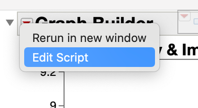

Re: How to automatically select table in journal in order to rerun in new window
The second option is the key to making this work the way you want.
Choose the Edit Script option
 Then edit the script like this:
 The first line tells JMP which file to open. Then on the second line insert "dt<<" before the first argument. That sends the argument to the specified data table.  Note that "dt" is an arbitrary variable name.
Hope this helps
-B
