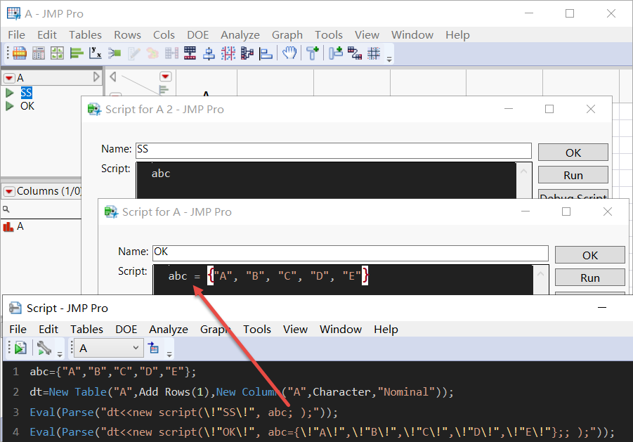

How to automatically combine this complex conversion?
In JSL, there is already a list variable abc. How can the values of this variable be written one by one into a new script without automatically re-entering the specific variable values
Thanks!
abc={"A","B","C","D","E"};
dt=New Table("A",Add Rows(1),New Column("A",Character,"Nominal"));
Eval(Parse("dt<<new script(\!"SS\!", abc; );"));
Eval(Parse("dt<<new script(\!"OK\!", abc={\!"A\!",\!"B\!",\!"C\!",\!"D\!",\!"E\!"};; );"));

jthi
Re: How to automatically combine this complex conversion?
Is this what you are looking for?
Names Default To Here(1);
abc = {"A", "B", "C", "D", "E"};
dt = New Table("A", Add Rows(1), New Column("A", Character, "Nominal"));
Eval(EvalExpr(
	dt << New Script("A",
		Expr(abc)
Or do you wish to have a script which will set abc variable to the list of values within the table script?
-Jarmo

lala
Level IX
Thanks!
OK
Eval(EvalExpr(
		abc=Expr(abc)

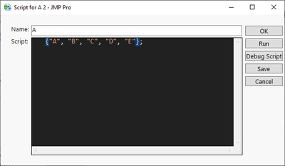

jthi
You generally have three options
// No variable
Eval(EvalExpr(
	dt << New Script("A1",
		Expr(abc)
// Freely define the variable name within table script
Eval(EvalExpr(
	dt << New Script("A2",
		abc = Expr(abc)
// Use expression to define variable and it's value within table script
// If you need abc defined outside of table script, you can use Eval(abc_expr);
abc_expr = Expr(abc = {"A", "B", "C", "D", "E"});
Eval(EvalExpr(
	dt << New Script("A3",
		Expr(Name Expr(abc_expr))
-Jarmo

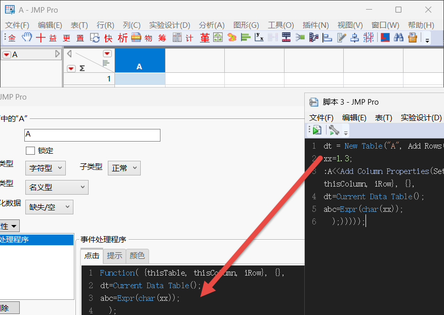

lala
Level IX
How can do it
Thanks Experts!
xx=1.3;
:A<<Add Column Properties(Set Property("Event Handler",Event Handler(Click(JSL Quote(Function( {thisTable, thisColumn, iRow}, {},
dt=Current Data Table();
abc=Expr(char(xx));
lala
Level IX
I want get:
abc=1.3;
mmarchandFSLR
Level VI
The JSL Quote() required for the Event Handler makes things more difficult.  I'm not sure there's another way than to Parse() it.
dt = New Table( "A", Add Rows( 1 ), New Column( "A", Character, "Nominal" ) );
xx = 1.3;
Eval(
	Parse(
		"\[:A << Add Column Properties(
	Set Property(
		"Event Handler",
		Event Handler(
abc=]\"
		 || Char( xx ) || ";
