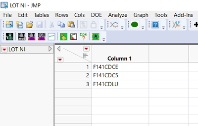

User will input the following file and the columns values are stored in the variable specVal .
I declared @ SPEC = ^specVal^ (Contains 3 values ) in SQL
Something doesn't seem to be correct.

@jthi is on the right track.  Print out the SQL code and try running it manually in SQL server.
I would point a variable at the data table to avoid scoping errors.

Will that work in SQL Server?  In Oracle I create IN lists and substitute them like this:
// Point dt to your table of values
dt = New Table( "SpecValues", Add Rows( 3 ),
	New Column( "Column 1", Character, "Nominal",
		Set Values( {"F14CDCE", "F141CDC5", "F141CDLU"} ) )
// Relevant section to create IN list
			Button Box( "OK",
				specVal = dt:Column 1 << Get Values;
				spec_in_list = "'" || concat items(specval, "', '") || "'";
				specVal1 = Start_date << get text();
				specVal2 = End_date << get text();
// SQL Code
	SQL = Eval Insert(
"SELECT t1.[vcLotCode]
   FROM [dbo].[vSMTDatat]  t1
  WHERE  (  (  (  ( t1.[vcLotCode] IN  ( ^spec_in_list^ )  )  )  ) ;" // Input from the user
	write(sql);

Jackie_
Level VI
Re: How to assign Multiple values to SQL variable
I really appreciate this. Thanks a LOT
