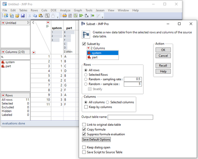

Step 1: Subset by system to get 3 tables.
· Choose Tables -> Subset, check Subset by and select the system column:

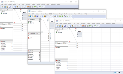

· JMP will give you 3 new tables:

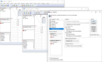

· Next join the 2 identical tables. From the menu of one table choose Table -> Join. Then select the other identical table and choose Cartesian Join in the Matching Specification drop down box. Click OK. When the new table is created, you can close the 2 tables you just joined, you won't need those anymore.

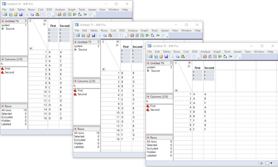

Repeat this step for each of the 3 system tables to get the 3 tables of possible pairs within each system. Don't forget to rename the columns in each table so when you later concatenate them, the columns will stack appropriately.

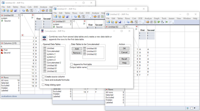

Step 3: Concatenate the 3 tables together and tabulate one column against the other.
· Choose Tables -> Concatenate. Then add the 3 tables into the "Data Tables to be Concatenated" box. Click OK.

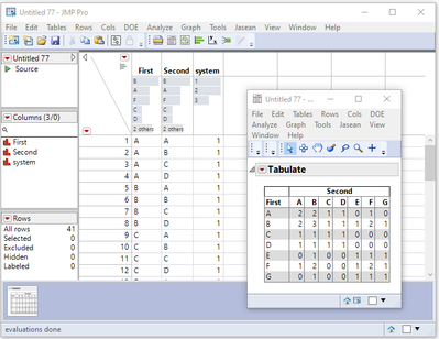

· Finally, from the table just created, choose Analyze -> Tabulate and drag the two columns into the drop zones for Rows and Columns to get the tabulation shown below.
