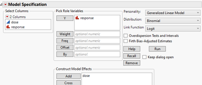

You may want to use GLM:
Then turn on Profiler:
Re: How to add the confidence intervals to a logistic regression plot?
It woks. Thanks for your help!
