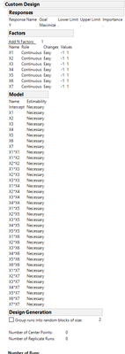

Thanks for your further reply, Lou. I tried your 2nd solution for my problem. But I am new to JMP, so I am trying to be careful using custom design.
Here is what I did. I add one response to maximize it and seven continuous factors. In my model I add RSM to account for 1st and 2nd order interaction.
Because I want a modified fractional factorial design with a resolution of V, which should have 64 runs. So I specified here the runs to be 64 and get my design table.
Then my questions are
1) Will this design process solve my problem as a modified fractional factorial design with the "axial points" I want?
2) I don't need center points for my design, but I do get center points in this custom design table.
louv
Staff (Retired)
Re: How to add "center or axial point" to fractional factorial design?
I guess my question back to you would be does your budget allow for running 64 experiments? If so, then the design approach that you shared is certainly a viable one. All of your main effects, two-way interactions and polynomial terms are well covered by specifying the RSM model that you chose. If you look at the design evaluation you will see that this design is very powerful. Having said that, most experimenters do not have a budget for that many experiments and rely on effect sparsity and effect heredity principles to try and delineate understanding by running fewer experiments. In fact the default number of runs for a RSM model with 7 continuous factors with the custom designer is 42 runs so 64 is only going to give you more power. A Definitive Screening Design only requires 17 runs and would be much more cost effective but may need to be augmented depending upon the number of active terms that surface. I never worry too much about this since I always know I can augment additional experiments to clarify any confusion. Most experimenters don't have the budget for 64 experiments, but if that is not an issue the design you propose would be quite effective.
