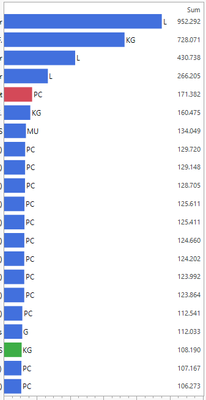

Hello JMP Community,
I would like to add a unit of measure as an additional information in my graph.

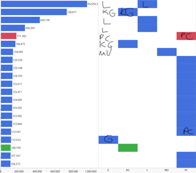

This is what i could create, painted in there is a possible solution I would like to have.
Thanks for a hint how this could be done!
Have a great weekend everybody!
Ben
What I also tried:
Label by value for the right part: here JMP takes the value which the bars are colored by. But this is a different categorisation I need and dont want to change!

Hi,
I figured out a workaround.
One can label the Unit of measure in the dataset and then select label by row in the graph builder.
If one still needs the "sum" attached to the bars, you can add a caption box "per factor" with the sum

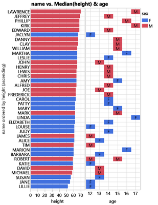

You could use a bar graph on the left and a heatmap on the right - then use Label by Value.
OK for the labels
... but you need the "color" for something else, right?
What a pity that custom efined row colors don't overwrite the color settings of the GraphBuilder plot ....
Some days ago I posed a wish for an overwrite dropzone
the idea: use an additional column to change the settings for some rows AFTER applying the GraphBuilder legend settings.
Kudos are welcome: GraphBuilder: Overwrite Dropzone
But perhaps there is no need for an overwrite drop zone - let's see what other users suggest within the possibilities of Jmp 17 ...
Names Default to Here(1);
dt << Graph Builder(
	Show Control Panel( 0 ),
	Variables(
		X( :height ),
		X( :age ),
		Y( :name, Order By( :height, Ascending, Order Statistic( "Mean" ) ) ),
		Color( :sex )
	Elements( Position( 1, 1 ), Bar( X, Y, Legend( 4 ) ) ),
	Elements(
		Position( 2, 1 ),
		Heatmap( X, Y, Legend( 7 ), Label( "Label by Value" ) )

Re: How to add categorical variable as caption box or similiar in a graph
Did you try the Units column property to see if the labeling is what you want?
Benjamin_Fuerst
Level III
Hi Mark,
Do I understand you correct that you are refering to the column property "unit"? I already am using the Units column property. Y units are a fixed currency. The additional Information I want to Show is to what units are These Costs specific ( X per L, X per g etc).
Any other idea how to Show that in a plot like this?
Never mind. I realize you are plotting some continuous quantity on the X axis on the left side. JMP assumes that all the bars have the same measure, but they don't in your case.
