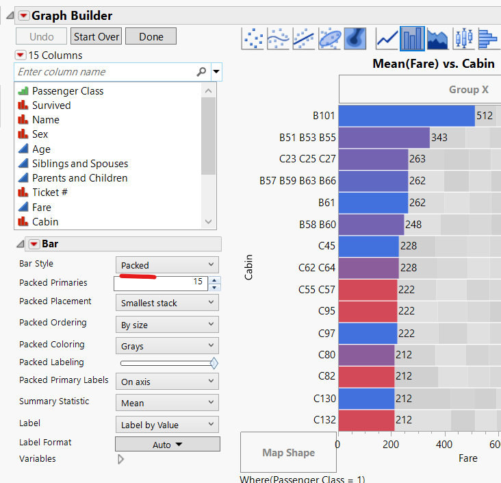

Re: Make Vertical bar chart showing only Top 10
Hello Ben,
How about Packed bar? Packed bar is slightly different what you want, but it is easier way to do.
Hi Yuichi,
thanks for pointing out this option. I was not aware of the packed bar chart.
It is a kind of workaround, but as you mentioned, it is slightly different as I need it.
Still the other values appear as the secondary bars in gray (depending on the local data filter one has set).
But you can separate them via "Packed ordering" to the bottom and just readjust the y axis so their are not visible any more.
Thanks!
