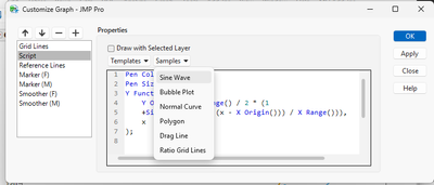

Y Function()
Some examples for example here (right click on graph > customize > +)

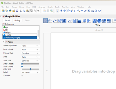

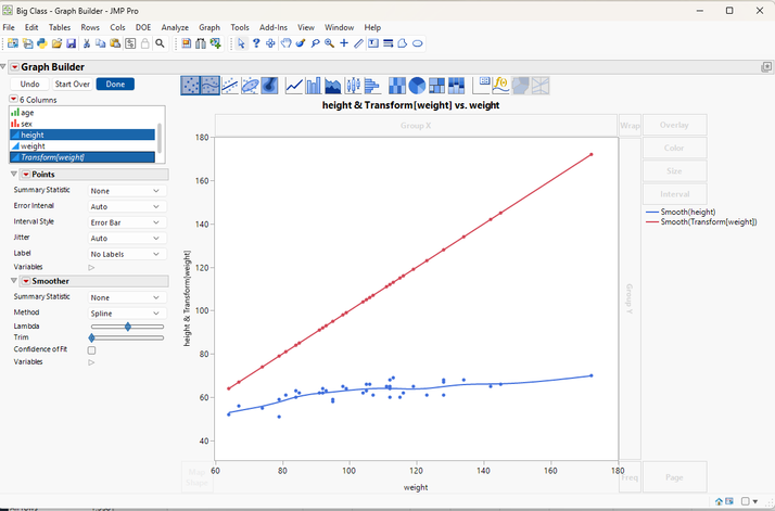

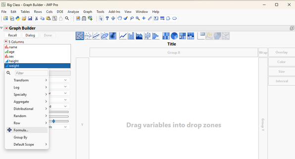

You can easily create a virtual column in Graph Builder and then use it in the graph.

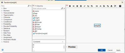

Right click in the Column selection window and select "Formula".
Set the formula to the column that is going to be your X column in the graph
Click OK and your new virtual column will be displayed
Now just drag you X column to the X drop area, and your Y column and the new virtual column to the Y drop area and you will have your graph.

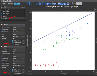

Adding to @txnelson's suggestion, note that you can rename the formula column (right click the name after building it), and then add a line chart element (right click in the graph space, add, line), and then hide the points on the 1:1 line and hide the line on the x variable (see screenshot) so you get a clean looking graph:
