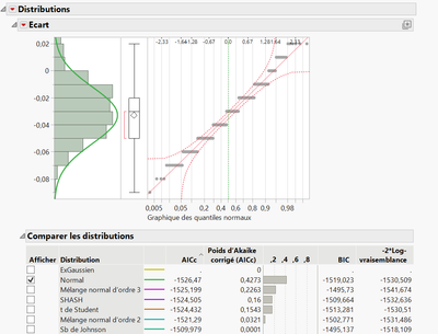

I'm working with measurement data that should follow a specific distribution.
My goal is to create a Folded Normal and a Rayleigh to compare along with other distributions already programmed by default in JMP in order to see if my data follows the expected one.
Here I fit all distributions with my data and look if the normal distribution fits the best according to the AICc. I would like to do the same with a Folded Normal and a Rayleigh law.
Here is the corresponding code :

How can I add a Folded Normal and a Rayleigh distribution to the Fit All while getting all the corresponding statistical data (Mean, Standard Deviation, Cp, Cpk...) ?

The folded normal and Rayleigh, are special cases of the Weibull distribution. Unless someone else knows a special trick, it is not possible to add additional distribution models to the menu.
