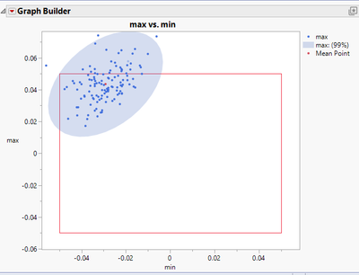

I'm trying to have a dynamic drawing of a spec "box" in graph builder but I can't seem to get it to work.  I've tried making the usl and lsl expr(usl) and expr(lsl) and done eval(eval expr()) but that did not work either.  Any suggestions would be greatly appreciated!
rpt=dt<<Graph Builder(
	Size( 527, 456 ),
	Show Control Panel( 0 ),
	Graph Spacing( 5 ),
	Variables( X( :Min ), Y( :Max ) ),
	Elements(
		Points( X, Y, Legend( 3 ) ),
		Ellipse( X, Y, Legend( 5 ), Coverage( "99%" ), Mean Point( 1 ) )
	SendToReport(
		Dispatch( {}, "Graph Builder", FrameBox,
			{Add Graphics Script(
				2,
				Description( "" ),
				Pen Color( "red" );
				Line( [lsl, usl], [usl, usl] );
				Line( [usl, usl], [lsl, usl] );
				Line( [lsl, usl], [lsl, lsl] );
				Line( [lsl, lsl], [lsl, usl] );
Want it to look like this (this was using the hard coding instead of lsl and usl)

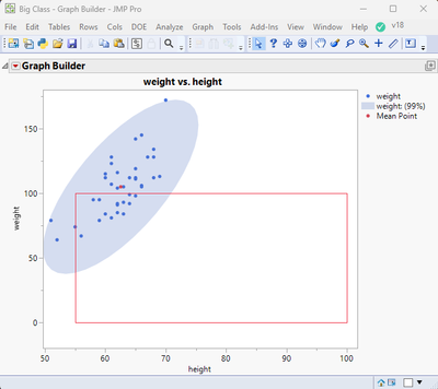

You could put the definition of xmin, xmax ... inside the graphics script. Here is an example with gets the values from the column properties.
This way it will work outside of the Here namespace -  e.g. when you save the graph as a table script.
:height << Set Property("Spec Limits",{LSL( 55 ), USL( 100 ), Show Limits( 0 )});
:weight << Set Property("Spec Limits",{LSL( 0 ), USL( 100 ), Show Limits( 0 )});
Report( gb )[framebox( 1 )] << Add Graphics Script(
	Pen Color( "red" );
	Xspecs= (:height << Get Property("Spec Limits"));
	xmin=Xspecs["LSL"];
	xmax= Xspecs["USL"];
	Yspecs= (:weight << Get Property("Spec Limits"));
	ymin=Yspecs["LSL"];
	ymax= Yspecs["USL"];
xMat =  Matrix({xmin, xmin, xmax, xmax, xmin});
yMat =  Matrix({ymin, ymax, ymax, ymin, ymin});
	Line( xMat, yMat );

Here is an example of one way to code the example
Names Default To Here( 1 );
dt =
// Open Data Table: Big Class.jmp
// → Data Table( "Big Class" )
Open( "$SAMPLE_DATA/Big Class.jmp" );
gb = dt << Graph Builder(
	Size( 527, 456 ),
	Graph Spacing( 5 ),
	Variables( X( :height ), Y( :weight ) ),
	Elements( Points( X, Y, Legend( 3 ) ), Ellipse( X, Y, Legend( 5 ), Coverage( "99%" ), Mean Point( 1 ) ) )
xmin = 55;
ymin = 0;
xmax = 100;
ymax = 100;
//eval(evalexpr(
	Pen Color( "red" );
	xMat = Matrix( xmin );
	xMat = xMat || Matrix( xmin );
	xMat = xMat || Matrix( xmax );
	yMat = Matrix( ymin );
	yMat = yMat || Matrix( ymax );
	yMat = yMat || Matrix( ymin );
	Line( xMat, yMat );

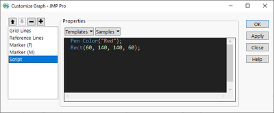

Re: How to add a graphics script but using a variable vs a hard coded value
Where are the limits coming from? Column properties? Do both columns have limits? Are they same? Do you know column names beforehand? Are you using column switcher?
Names Default To Here(1);
dt = open("$SAMPLE_DATA/Big Class.jmp");
	Size(525, 454),
	Show Control Panel(0),
	Variables(X(:weight), Y(:height), Overlay(:sex)),
	Elements(Points(X, Y, Legend(9))),
	SendToReport(
		Dispatch({}, "weight", ScaleBox,
			{Min(38.9121338912134), Max(180), Inc(20), Minor Ticks(0)}
		Dispatch({}, "height", ScaleBox,
			{Min(47.513125), Max(180.625510686239), Inc(20), Minor Ticks(0)}
fb = Report(gb)[FrameBox(1)];
low = 60;
high = 140;
Eval(EvalExpr(
	fb << Add Graphics Script(
		Pen Color("Red");
		Rect(Expr(low), Expr(high), Expr(high), Expr(low));
-Jarmo
@hogi wrote:
Eval(EvalExpr(
		Pen Color("Red");
after saving the plot, the code will not work anymore.
low & high should be defined INSIDE the graphics script - see previous post.
How would you save the plot so they wouldn't work?
View more...
The values won't update if user makes changes, but without knowing where values are coming from, it is extremely difficult to take that into account.
Graph Builder(
	Size(525, 454),
	SendToReport(
		Dispatch({}, "Graph Builder", FrameBox,
				5,
				Description(""),
				Pen Color("Red");
				Rect(60, 140, 140, 60);
-Jarmo
