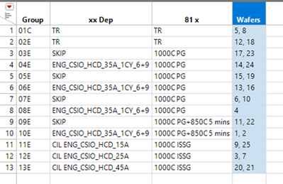

I would like to write a script/addin for the following.
Right now, I am doing this manually by using JMP menu options. I would like to achieve the same using script/addin:

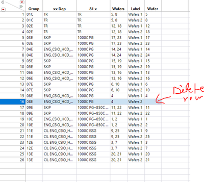

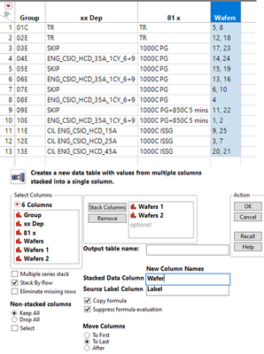

By selecting Column= Wafers. I go to Cols--> Utilities--> TEXT to COLUMNS. Then I select Delimeter=,
It gives me additional columns Wafers1, wafers2 which I then stack. Stack Data colum name= Wafer
I then delete any empty row with Data= empty.

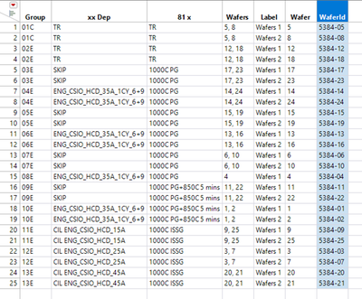

"Next, I add a new column named WaferId. This column concatenates the Lotid string with the Wafer column in the following format: WaferId = "5384" || "-" || Right(Char(:Wafer), 2, "0"). I would like the Lotid to be entered manually by the user in a popup box." In this case. Lot id= "5384"
Groupxx Dep81 xWafers
01CTRTR5, 8
02ETRTR12, 18
03ESKIP1000C PG17, 23

Final Output is

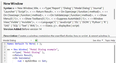

The part with the "manually entered Lot ID", you can steal from the Scripting Index:
New window - Modal Dialog

I was able to get these through LOG. But how do I do the last part? I.e. get input from user and ask for the input from user through text box popup?
dt= current data table();
dt<< Text to Columns( columns( :Wafers ), Delimiters( "," ) );
dt2=dt1 << Stack(
columns( :Wafers 1, :Wafers 2 ),
Source Label Column( "Label" ),
Stacked Data Column( "WaferId" )
dt2 << Select Where( :WaferId == "" ) << Delete Rows;

Go to the Scripting Index
     Help=>Scripting Index
Filter on New Window and in the Examples, use the down arrow and select Modal Dialog
