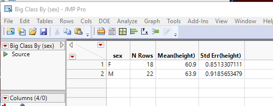

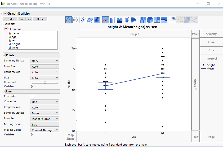

If you are using Graph Builder for the charting, you may not have to create a summary table with the Standard Errors.  Here is an example using Graph Builder with the sample data table, Big Class. No Summary was done on the Big Class data before running the Graph Builder on it.   I have also listed the results of running a Summary on the same data to show that Graph Builder is displaying the same results that one would get from the Summary Platform
