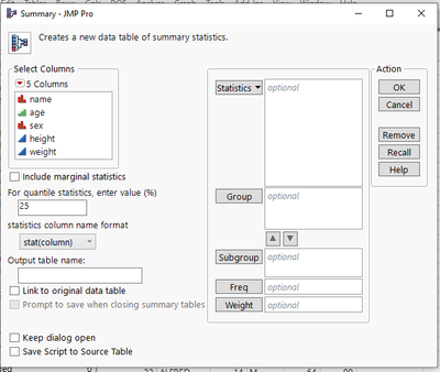

I was wondering if someone could offer a solution for how to allow the Summary input box to show up but have the "Linked to source data" option unchecked.  I tried this:  dt<<summary(link to original data table(0)); but it just runs the summary with nothing selected.  For right now I'm using just dt<<summary(); but I have to remember to click the check box or else when my macro closes the table being summarized the summarized table closes as well.

Here is a method that permits the Link to Original Data Table to be unchecked,
And the code for the remaining script not to be run until the Summary window is processed

obj = dt << summary();
win = Window( "Summary" );
(win[CheckBoxbox( 2 )]) << set( 1, 0 );

Seems that Summary is executed directly when there is any argument. And did not find Preferences for Summary either. So I did not find a simple solution.
One workaround would be to generate a modal window to select the input you need to perform summary (e.g. col list box etc. to query ..).
But in your case, why do you wrap the dialog for Summary in a modal window? It would work perfectly w/o.

Perfect thanks Jim!
