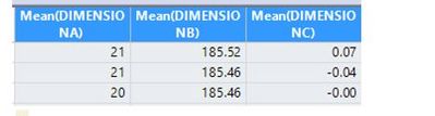

and I would require to Summarized this (get the average) and I will have the following data table:2.JPG2.JPG
Now for my final table, I would want to rename the following:
Mean(DIMENSIONA) to "DIMENSIONA" only ,
Mean(DIMENSIONB) to "DIMENSIONB" only,
Mean(DIMENSIONC) to "DIMENSIONC" only and so on...

Re: How to Change a COL name of a SUMMARIZED table
You will not have to rename the columns in the summary output table if you use the
     statistics column name format( "column" )
option in the Summary Platform.  This is also a selection in the interactive dialog box on the lower left side, in an area titled "statistics column name format:
Here is a simple script illustrating what I am saying
Names Default To Here( 1 );
dt = Open( "$SAMPLE_DATA\Fitness.jmp" );
dtSum = dt << Summary(
	Mean( :Age ),
	Mean( :Weight ),
	Mean( :Oxy ),
	Mean( :Runtime ),
	Mean( :RunPulse ),
	Mean( :RstPulse ),
	Mean( :MaxPulse ),
	Freq( "None" ),
	Weight( "None" ),
	statistics column name format( "column" ),
	Link to original data table( 0 )
Thanks a lot! Works perfectly!
