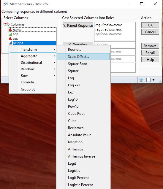

You can change the output scale to several different options by right clicking on the axis you want to change, and then selecting "Axis Settings".  It can handle a log axis.  However if you are looking for the differences to be in percentages or ratios, you may need to transform your data.  This can be done when selecting the data.   When you open the Matched Pairs Platform, you can transform the data into the values you want by simply right clicking on the column you want to transform and then to select the appropriate transform.  Not all transforms are selectable.  You may need to use your own formula and create the transformed data.  For your request for a log, it is selectable, however for a ratio or a percentage, you will need to use the Formula option, and specify the formula to be used in the transformation

Good to know these options, seems that answers my question.
but for example when I transform the a and b columns for the y responses how do I set the plotted x-axis to the mean of a and b column without transformation?
I believe for percentages and ratio plot the x-axis mean remains without transformation, only on log graphs the mean are also logarithmical.
