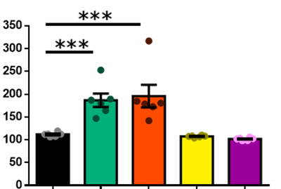

Hello JMP Community,
I would like to add an outline/border around each bar in a bar chart and customize its width. How can I achieve this in JMP?
As shown in the image below , I would like to add a border or outline around each bar.
I've heard of a workaround that involves overlaying two bar charts to simulate an outline. However, this method doesn't seem to allow for customization of the outline's width. Is there a way, either through the Graph Builder interface or by editing a script, to apply an outline to each bar and independently change its color and width?
I think using second bar chart should be ok solution, but it will require some work as you would have to create extra column to get heights correct and then modify width proportion. This has been done with that method

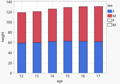

Here is exmple script you can run and then explore how the graph has been built (order of barcharts has been changed, width proportion is modified, color is changed and so on...)
@jthi has a good solution. I have a tendency to use the JMP graphic primitives that allow you to directly draw lines and rectangles with the ability to color and define thicknesses.
See Add Graphic Script in the Scripting Index and Scripting Guide for documentation and examples of how to do this.
Using Graphic Script. You have to know how many bars you have, and I think you cannot get that information from BarSeg object. So, it is easier to do with supporting marker added to graph (it can be hidden from final plot)
Use Marker Draw Expression. Does require adding marker, it is more difficult to implement, but is most likely more robust option
I don't have time to write-out these options now, but they do exist

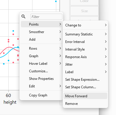

Thank you so much for your detailed responses. It was very helpful. But there is one more thing I'd like to do.
When I use Set Marker Draw Expr to draw a bar border, it is drawn on the top layer. Consequently, when I add error bars or individual data points (via a dot plot), the custom border is drawn over them. Is there a way to control the drawing order (layer) of the border so that it appears behind the data points?
For highly customized graphing, do people typically use scripting languages like R, or dedicated software such as GraphPad Prism?
Re: How to Add/Customize a Border (Outline) to Bar Charts
Created:
Nov 16, 2025 10:07 AM
| Last Modified: Nov 16, 2025 7:09 AM(2692 views)
| Posted in reply to message from Yo_ITO 11-16-2025
you can adjust the oder of the individual element: right click into the graph and change the order:
If there is just one plot type, just add 20 and customize them.
Graph Builder is orders of magnitude more flexible / powerful than people might think at first glance. This is the trick: a smooth transition from very easy drag and drop to highly customized graphs. With Set Marker Draw Expr you already got in tough with one very elaborate feature - but there are many more features. No need to use another plotting tool.
Draw your chart with the new borders and the error bars. Then right click on the graph and select Custom. It will bring up a dialog box where you can select the error bars and move them to the front. Close the dialog box and then go to the red triangle and select save script. You can then examine the script it produced and you will see what is necessary to move the error bars to the front using jsl.
